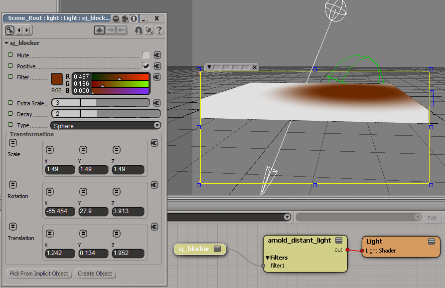

Example
Filtering a white distant light by a sphere blocker
