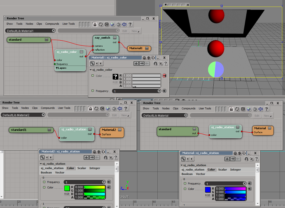

Example
In this scene, there are two ground grids. The left side one emits green on Frequency 1, the right side one emits blue on the same Frequency.
The top grid is a plain standard reflector.
The red sphere has a ray switch shader, that evaluates sj_radio_color for reflected rays.
This shader listen on Frequency 1, so returns a different reflected color based on the objects (the ground grids) that fired the reflection rays after broadcasting the color value.
